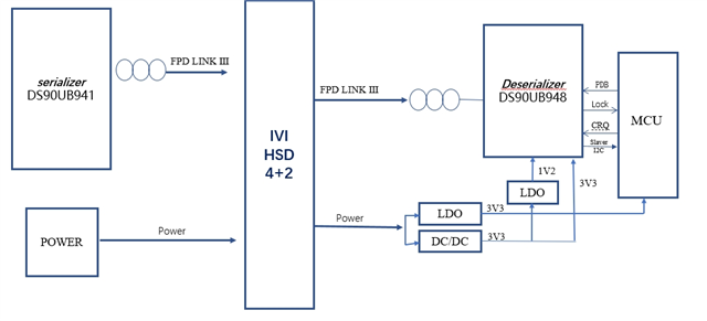

TI941 with TI948, a 941 read could not find 948 during use, and normal communication could not be established, resulting in a black screen.

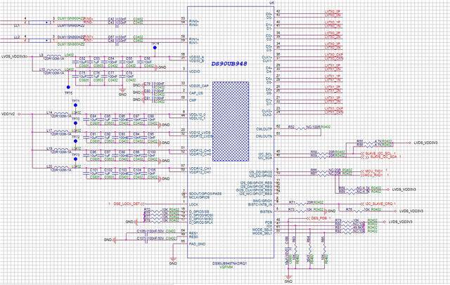

The customer deserializer TI948 circuit is a two-channel LVDS input and two sets of OLDI outputs of 1lane+4lane. The serializer chip used on the host side is TI941. The above issue occurs during real use and currently the bench test does not occur, so no valid exception information is available.  Could you please help check out if this is TI948-related-circuit issue?

  • Hey Cherry,
    I don't see an issue with schematic. Seems like it's setup for STP 5 mbps backchannel dual OLDI output.

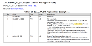

    Does the PLL unlock status affect both image display and transmitted I2C communication? Or is the lock/unlock primarily a video signal based clock stable?
    If you have I2C issue that could be an issue with forward channel or back channel. But if you don't have video that's only a forward channel issue. Your lock status by default will check for active video, see register 0x34 on Des side.

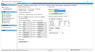

    You could try running patgen testing from 941AS to see if you get lock on 948 as a first step. Then you can try different timing configuration to narrow down where the issue is coming from.
    941AS can generate internal timing and CLK and can do a different combination of timing/clk modes - This helps isolate whether the issue is with timing or CLK or whether it's coming from the input side (video/clk source) or whether it's coming from the 929 itself.
    1- Internal - Everything will be internally generated; HS, VS, DE, CLK and Video (if no issue is observed then the issue is likely coming from the video source)
    2- Internal w/ext clk is HS, VS, DE and Video are generated internally but using External PCLK (if you see an issue in this mode, this point to an external CLK issue from the source)
    3-  External is HS, VS, DE and CLK are generated externally (if you see an issue in this mode, this point to an external CLK/timing issue from the source)
    Next, you need to choose Timing Source - choose timing based on the 3 modes mentioned above and then for spec you could choose the resolution you need for your display, or can customized your own. You could run fixed pattern or you could select Color Bars or if you choose to do fixed patterns and could enable scrolling to go through multiple patterns, so whichever method you want. Then finally, you could Enable Generator to start sending the Patgen with the setting you have configured.
