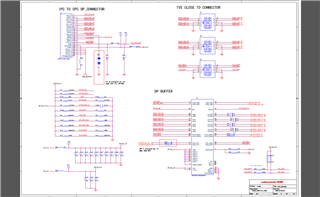

    Our exprienced:
    During the ESD test of the entire machine, when the 2/4/6/8k contact discharge is applied at a interval of 1s or a single time, the screen will go black. After stopping the electrostatic discharge, the screen will recover for about 2 seconds.
    During the test process, all registers of DP130 are read at intervals of 1s. When the black screen is found, register 0X19 changes from 18 to 10 and then recovers to 18. This register is not described in the specification. What does this register represent, or does it mean that the DP130 anomaly causes a black screen when static electricity is applied? How to solve this problem?
    Here are our schematic and configuration.Please help to check.
    Thanks.
    Our schematic:
    Our register configuration:

    The datasheet's ESD specifications are for the HBM and CDM which are not the same tests as the IEC ESD testing.
    Zach

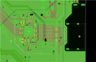

  • Hi Tian,
    Can you provide me with the part number of the ESD device you're using?
    PCB layout is also very important for dissipating large ESD currents, here is our ESD layout guide that goes over best practices for optimizing PCB layouts for ESD.

  • Hi Zach,
    The ESD device we're use is "SEMTECH_RCLAMP0524P";
    After these day's test,we found that it when ESD testing,the BER of main link would be higher,cause the screen reconnect.
    The signal transferred by the DP130 will have a black screen problem, and the main control directly drives the screen will not cause problem.
    Here's our PCB design

  • Hi Tian,
    Our device TPD4E05U06DQAR  is a pin to pin replacement with lower clamping voltage, this could help protect the redriver IC.
    We also have a pin to pin replacement with a 3.6 V working voltage that would be a better solution if your data line voltages don't swing above 3.6 V, ESD204DQAR.
    Perhaps you could try one of these devices and see if the black screen problem persists.
    Sebastian
  • Hi,Sebastian
    First of all thank you for your comments.
    Here are the tests:
    We use TPD4E05U06DQAR   instead, when ESD is applied to the whole machine still black screen;
    While use ESD204DQAR instead,it will be flicker when work.
    Wheater DP130 device can pass ESD test?
    Thanks.
  • Hello, Tian,
    The DP130 only provides the HBM and CDM in section 7.2 ESD Ratings of the data sheet.
    These ratings are not the same as the testing that you are performing.
    Zach
