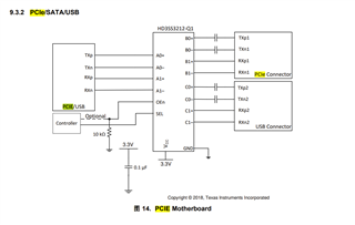

Can this model be used for PCIE 1:2,?the input mentioned on the block diagram can be PCIE control, output one is  PCIE, another  one  is  USB control ? can it output two PCIE control?
Is there a PCIE3.0 switch, one input and two outputs?
    Yes,
    You can use HD3SS3212 or TMUXHS4212.
