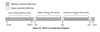

How to configure these three registers in gpio mode if you want to read the gpio state
0x29 0x30 0x2B
  • You need debouncing only for mechanical switches. As far as I can see, debouncing affects only the interrupt, but not reading the pin itself.
    (There is no register 0x30; the table in section 8.6.2.15 should say 0x2A instead.)
  • Hi COCO J,
    If you desire to write data to the debouncing registers, then you would need to follow the data format listed in figure 24 with correct device slave address, register address (either 0x29, 0x30, 0x2B), and the data you want to put into the register.
    Configuration of these registers is done via the I2C bus on pins 23 and 22.
    FYI,
    a bit value of 0 enables the debounce feature for that row/col pin, this is the default value.
    a bit value of 1 disables the debounce.
    Tyler
