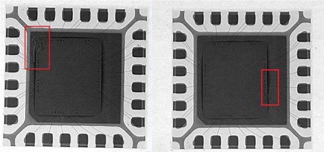

Hi team,
Customer found the defect in the X-ray images. He would like to know:
1.cause of defect
2. Does such defect affect the function
Annie

Hi Annie,
Apologize for the late response since E2E was offline.
However, please confirm if you have already used this in your design and you are seeing a functionality issue. Also, can you please confirm a working device shows the same x-ray?
Regards, Nasser

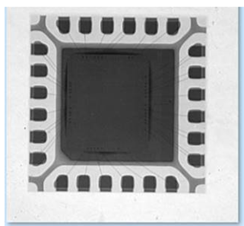

Hi Nasser,
Not used yet, they just find the defect from the X-ray image. The below photo is from the good part.

Hi Annie,
Suggestion is to first use this part on a test board or evaluation board. This may not affect functional since this seems to be more on the molding compound used versus actual bond wire. Once this is done, please let us know and if needed we can take the next step.
