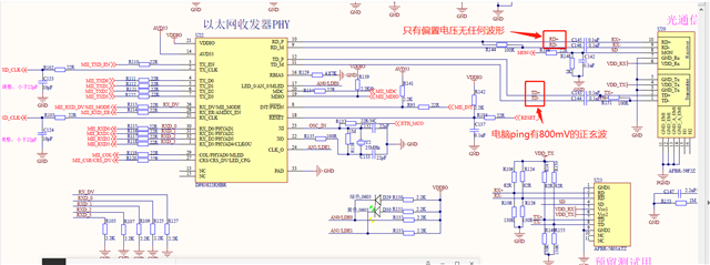

Hi Team,
DP83822HF cannot be pinged using a PC (DP83822HF optical port, rewired to RJ45 connector via fiber optic transceiver, connected to computer side) .
Please see the following debugging steps:
1) 2 fiber transceivers are used to send and receive the transceiver, which is able to ping successfully and prove that the fiber transceiver is not a problem.
2) Use the internal loopback mode of the DP83822HF for transmit and receive. The oscilloscope test signals such as the Digital TX RX CLK of the MII are good and the transmit and receive interrupts are normal.
3) Using DP83822HF normal mode (non-loopback), ping the device on the computer side and finding that the ping is not possible. Through the test waveform it's found that TD_p/TD_m had a sine wave of 800 mV while the received rd_p/rd_m had only bias voltage but no waveform.
4) Reset signal of DP83822HF is normal and there is a reset action at power-up, MDIO communication is good.
Please see the schematic below:
And the reading register is as follows:

Could you please help check this case? Thanks.

  • Hi Cherry,
    Just to clarify, is this for the DP83848 or the DP83822? You mentioned the 822 in your post but the dump is of the 848. Is the correct register dump attached?
    In your design, are the resistors and capacitors should be placed as close to the fiber transceiver as possible?
    Would you be able to provide a picture of this?
