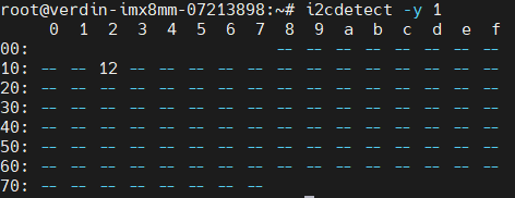

The customer uses an internal pattern generator to test if the hardware connection between master and slave is correct. Follow the "internal test pattern generation feature of the explore FPD-Link III IVI device", but it does not appear to have any graphic display on the screen. Could you please help check if the register configuration and flow are correct or complete:
A simplified connection diagram is shown below and the LCD display is now debugged first:
After starting the board, using i2c-tools, it can be seen that the 941 device address is 0x12:
I2C_BUS_NUMBER=1
941_ADDR=0x12
Reading des_ID_des_ID_1 register 0x06 has a value of 0x76, and shifting right by one bit results in a 928 deserializer ID of 0x3B:
Then execute the script for the register configuration of the pattern generator, “941as_800x480p_PATGEN.sh”, using the internal timing and the internal pclk:

  • Hello Cherry,
    due to the delay caused by the E2E maintenance, we will get back to you on Monday!
  • Hi Cherry,
    i2cset -y -f -r $I2C_BUS_NUMBER $UB941AS_ADDR 0x65 0x03
    i2cset -y -f -r $I2C_BUS_NUMBER $UB941AS_ADDR 0x64 0x11
    The following commands set the patgen to display a black pattern first. It also sets the timing select to take the timing from external video. Can you set 0x65[2]=1? This will enable the pattern generator to create it's own video from the timing which you have programmed.

  • Hi Ben,
    Thank you for the response.
    941 address: 0x12
    After power-up, no other configuration is made, only register 0x3 is configured with a value of 0x28 to turn on I2C direct mode so that the registers from the slave device can be accessed. When I2C is set to pass-through, from i2cdetect it  can be seen the address from slave 928 as 0x2c:
    Then checking register 0xC for 941AS and register 0x1C for 928, 941 register 0xC value is 0x03 and 928 register 0x1C value is 0x03.
    And as you can see, the 941 register 0xC bit0 = 1, bit1 = 1. According to the manual, this indicates that a cable link was detected but a CRC error occurred during communication with the deserializer. What might be the problem with this error after power-up without additional operation and configuration? Is bit1=1 possibly causing the above screen no display issue?
    Thanks and regards,
    Cherry
  • Hi Cherry,
    I am glad the 928 now has lock and the I2C address can be recognized. The CRC error may have to do with hardware, or it could be a CRC leftover from startup. Is the customer using a custom PCB or EVMs?
    Also, can you check the mapsel on the 928 and make sure the display can receive the selected color mapping?
    There are also tables in the 928 datasheet which show the different color schemes.
    Ben
  • Hi Ben,
    After setting the mapsel, it worked!
