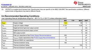

4. We use buck converter in our design (Input - battery and output 3.3V). In that case we are are not enabling voltage regulator by INH pin (CAN IC) and left open, is that ok.
5. We are giving 3.3V to Vsup, WAKE, Vin.

    5. The TCAN4550-Q1 has a minimum operating supply voltage on VSUP of 5.5V this is because there is an internal 5V LDO that is used for CAN.  If VSUP drops below 5V, the device will enter a Under voltage protected mode.
    You will not be able to operate the device with VSUP = 3.3V.  You can use 3.3V for VIO which sets the digital IO signal levels for proper communication with the MCU.
