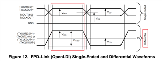

Just want to have a quick confirm, if we want to verify the output data of 924. Is it stand for 1 or 0 when it is logic high?

Output data on the 924 RGB interface is logic 1 when active

Hello Casey,according to ds90ub924-q1.pdf figure12 ,it seems logic 0 indicate high level signal when test with differential probe of oscilloscope,how about your suggestions?
Hello Tong,
the output interface is OLDI which are differential signals and do not reference to ground.
