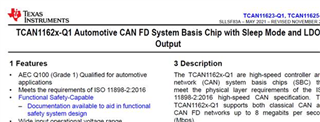

thanks for your help support always. My customer would like to know that does TCAN11623 meet the ISO11898-5 (2007) specification? In the specification, there is only information that satisfies ISO11898-2.

ISO 11898-5:2007 was withdrawn by ISO and is no longer a standard. The governing physical layer standard is ISO 11898-2, which is why this is mentioned in the data sheet.
