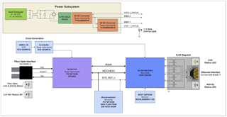

I have new design that I'm in the board bring-up phase with and I have some familiarity with the switch and this is my first design with the DP83822 PHY.  The PHY is pin strapped to work in 100base-FX mode and is connected to a 100mbs 1x9 optical module.
The design is using a comparator on the signal detect pin and it's working correctly as the datasheet mentions that the signal detect is active high.  With no fiber connected the SD signal is 0v with the fiber connected the SD is 2.4V.    The LED_0 pin is remaining high whether the fiber is connected or not.
I have access to read registers via the MDIO/MDC and I'm seeing that the bit[14] in the control register #2 0x000A is set. Bit[2] in the basic mode status register 0x0001 is never set with the fiber connected.  I'm starting to look in the datasheet to see if there are any other pertinent bits I should reading to help troubleshoot this. Any advice is welcome.

  • Hi Bruce,
    Could you share a block diagram of your design? Are you facing any issues as of now?
    The LED_0 'Good Link' setting doesn't accurately describe the Fiber status and Bit[2] in Register 0x0001 only works for Copper, it will not tell you if Fiber link is up or not (as I'm sure you've noticed). When using Fiber Auto-neg doesn't make a difference, I tested it out with auto-neg both enabled and disabled. Setup was our 822 EVM with an SFP Module connected to a modem.

  • The design I'm working on is a media converter that is using a 10/100 UTP port and a 1x9 100mbs Optical module.  The signal detect is going thru a comparator to the LED_1 PIN.  Have you tried 100Base-FX mode with RGMII?  the datasheet doesn't explicitly have it listed as working like it does for RMII.
