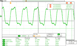

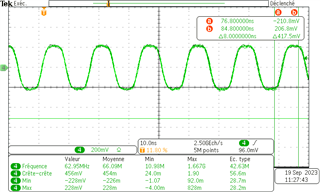

CLK_O_SEL (IO_MUX_CFG register) has been modified to monitor TX clock on scope:
Channel A transmit clock: CLK_OUT = 25MHz
Channel B transmit clock: CLK_OUT = 25MHz
Channel C transmit clock: CLK_OUT = 25MHz
Channel D transmit clock: CLK_OUT = 25MHz
Default configuration (ref clock): CLK_OUT = 25MHz
Shoud we have 2.5MHz since the link is 10Mbps?
Can we say RX is ok ? SOC-PHY connection is ok ?
I don't know where is the issue, what I have to check and the tests I could do...

    Indeed this was related to RGMII delays.
    Now we face to 10Mbits auto negotation whereas both phy are 1G capable. Could it be related to delay configuration values ?

    We tried this by deactivating 10M&100M advertising but the 869 is unable to link up. As soon as the phy soft reset is done, link is down, it tries to connect but never links up.
    We don't have standard rj45 connector on our board, but specific connector and a custom cable (half-meter) with a rj45 at the end.
    We have several custom cables and 4 869-phys:
    With one of these, phy never links up
    With another one, 10M link-up after 30 seconds (always the same time)
    With another one, 10M link-up after 30 seconds or sometimes several minutes
    Board and cable schematics have been checked.
    Please note that we have 4 instances of 869 phy on our board and all of them behaves the same way, linking-up at 10M.
    ethtool running on the PC warns to check our cable.
    Can we learn something from MSE registers? (one or more ports are unusable ?)

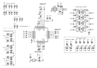

  • Hi Guillaume,
    Could you provide a block diagram of your setup?
    This connector setup in specific is what I want more detail on. Do you have a transformer on the board?

  • Hi Alvaro,
    Here is the schematic. I don't know if it will readable. Please let me know.
    We tried with a short rj45 cable connected tothe transformer, but we have the same behaviour, linking-up 10M.
    We tried a loopback 869-869, linking-up 10M.
  • Hi Guillaume,
    As you suspected, the schematic is difficult to read. Could you send it as a pdf?

  • Hi Alvaro,
    Measurements have been done in test mode 2:
    - At the end of cable:
    - Magnetics, phy side:
    - Magnetics, media side: no picture, but all look good.
    We tried with 2 sets of custom cables. At the end of cable we have:
    - Set 1: 1 port with 0.6V amplitude, 1 port with 0.4 (see picture), 2 lasts ports: 0,7V.
    - Set 2: all ports: 0,7V
    The 2 sets behave the same way (very long to link-up, always @10M).
    On the magnetics, media side: like your example output.
    On the magnetics, phy side: see picture.
    Guillaume
