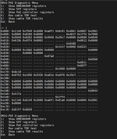

Here is register dump when unit is connected to laptop that fails to link:
As can be seen, bit 3 in register 6 (ANERR) is zero. We suspect this is the cause of auto-negotiation problems.

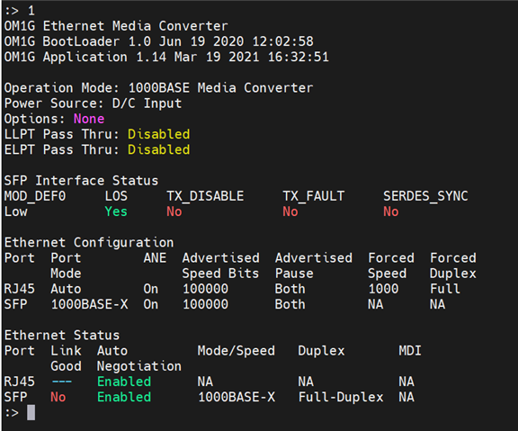

Here is configuration and status output.

  • Note: In the register dump, LP_NP_ABLE=0 in ANER and AUTONEG_ERR=1 in INTERRUPT_STATUS.
    There is some issue with the DP83869HM or its configuration as other devices link with the Intel NICs in these devices.
  • Hi Dave,
    What speed is expected to be established? I see from the register dump that the DP83869 is only advertising 1000Base-T full duplex support, but the link partner does not support 1000Base-T (register 0xA) and is only advertising 10Base-T support.

    You are correct the DP83869 is only advertising 1000Base-T full duplex support.  It is configured as a 1000BASE-T to 1000BASE-X media converter.  The DP83869 in the OM1G is configured initially by strap options, and then by an embedded micro in the unit based on switch and console configuration.
    The laptop is configured for 1 Gbps Full Duplex.  Same problem occurs when it is configured to Auto Negotiation mode.  If one switches between these two modes, the units will link. But if the OM1G is powered on after the laptop is up, the laptop invariably starts advertising only 10BASE-T or 10/100BASE-T and the units don't link. The next page bit for gigabit is always 0.

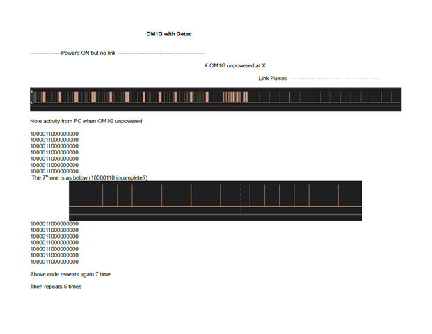

    We built a cable breakout to look at the fast link pulses (FLP) from units.  We see the laptop get stuck only sending 1000011000000000 FLPs.

    I think the Intel I219-LM must be getting stuck in link fail mode and FLPs from the DP83869HM aren't causing it to resume normal auto-negotiation. I don't believe it's a configuration issue. Multiple laptops with this part have been tested and they all have same behavior.  Possibly, both devices get stuck in link fail mode.

    Many of our customers use fiber to the desktop for security.  Thus, the need for media converters and the limitations they impose on data rates.  Your original comment that the link partner was only advertising 10BASE-T made me suspect that it was necessary to advertise 10BASE-T in the DP83869.  We also saw in the FLPs that the base page being transmitted by the laptop only advertised 10BASE-T support when the DP83869 was powered down.
    It's a puzzle why this change results in the devices linking at 1000Mbps.
  • For completeness, I've added a screen shot of FLPs captured from Getac laptop when link is down.
