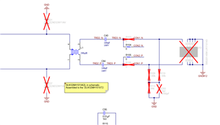

DP83TC812EVM-MC: which choke would be compatible for both DP83TC812RRHARQ1 and DP83TG720RWRHATQ1
Part Number: DP83TC812EVM-MC

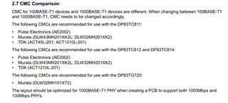

My goal is to design a PCB that should fit.DP83TC812RRHARQ1 100 baseT-1 and  DP83TG720RWRHATQ1 1000 baseT-1
In the filter circuit, CMC (L1) is used in DP83TC812EVM-MC is  DLW43MH201XK2L,
Since this part DLW32MH201XK2 is not present on the evaluation board (DP83TC812EVM-MC) but recommended in the datasheet.
Has this part been tested ?
Shall I use this part?
