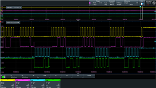

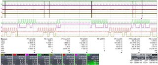

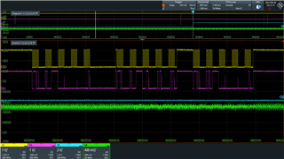

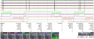

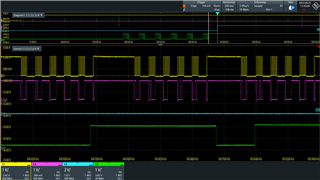

  • Hi Glenn,
    thank you for your fast answer, we did some investigations with your suggested settings but it had no effect.
    Here some pictures from the I2C bus at the 953:
    compared to what we could see at the 954:
    yellow = scl
    pink = sda
    I guess the problem is the remaining low SDA and SCL after the first five packets at 953 while it's high at the 954 (as expected).
    Why are SDA and SCL held low?
    Christian

  • Here an overview of the i2c communication the both upper gaphs are the scl (green) and the sda (purple) at the 954 and the lower two are scl (red) and sda (yellow) of the 953.
    the part I am concerned abotu is after the 10th clock package, where the scl and sda were going high at the 954 with an stop condition while both signals remain low at the 953.
    This picture is just further zoom in at the described position.
    Christian
  • Here is a picture of what I was expecting instead.
    There is clearly a stop bit and then a new start for the next packets sent.

  • There are some issuers with other devices as well that's what I could see for ICC communication:
    yellow -> SCL HEAD
    pink -> SDA HEAD
    blue -> SCL VPU
    green -> SDA VPU
    There is a stop condition after the last command, on the VPU followed by a stop condition on the HEAD. Then there is a start condition on the VPU with a register value which is also sent at the head afterwards. But why is the Head answering at this condition immediately? Shouldn’t it wait for another register value?
    Then the communication goes on and the ICC sends more and more registers, the VPU acknowledges them each. But after the last packet sent from the ICC the bus on the HEAD remains low. I think that’s the reason why the Acknowledge from the Head does not get to the ICC and the bus keeps blocked.
    I would expect here an ACK followed by a stop condition, so the bus could be free on the VPU and the head.
    After 300 ms the bus gets Free again like this.
    That's what I expect to see there instead.
    A test without the levelshifter is running.
    We're using the LSF0204 at the moment.
    Christian
