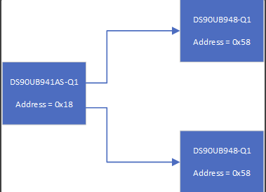

At present, our company has encountered the following issues while debugging the TI941+TI948 split screen scheme:
The overall block diagram is as follows:
941 Configuration:
0x1E, 0x01, port0
0x03, 0x9a, pass_ Through
0x1E, 0x02, port1
0x1E, 0x01, port0
Address 0x07, 0x58, 948
0x08, 0x5c, port0 948 address alias
0x1E, 0x02, port1
0x08, 0x5e, port1 948 address alias
After attempting to configure as above, only 948 (0x2E) on port0 can be accessed, while 948 on port1 cannot be detected
May I ask if there is any issue with the above configuration? How can I debug the 948 on port1 that cannot be detected?

  • Hi Tony,
    Port0:
    0x5a =  0x99  :bit7 is FPD-Link III Link Ready status for selected port
    Port1:
    0x5a = 0x19
    Both ports seem to think that they are transmitting single FPD-Link III on port 0. The reading from port 1 seems incorrect. Can you double check the DUAL_CTL1 register to make sure the 941AS is strapped into splitter/independent mode?
    Is the 941AS cable plugged into port 0 for both of the 948s?
    Jack

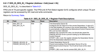

  • 1. DUAL_ I have configured the CTL1 register on my end. 941 and two 948 are on the same small board, and there is no need to insert them. It can be confirmed that they are connected;
    2. As the addresses of the previous two 948 are the same, I am trying to modify the IDX pin of port1 948 to 0x30, which is different from the 948 0x2c on port0,
    However, currently it is still unable to communicate with 948 on port1;

  • Hi Tony,
    Thank you for providing the configuration sequence. Because we recommend configuring DSI settings while DSI inputs are inactive, can you swap lines 4 and 5? This won't fix the I2C issue but will ensure there aren't any errors for video setup.
    Can you confirm that the output of the 941AS goes into port 0 for both of the 948 devices? I want to make sure the hardware configuration is correct.
    Because the IDX pins are now modified to provide a different address, can you check the port 0 and port 1 values after the 941 is configured. This will let us know if the 941 is correctly reading the 948 configuration for both devices.
    Jack

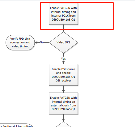

  • 1. Currently, we have configured the i2c of 948 on port 1 separately to address the issue of communication issues with 948 on port 1. Currently, it is preliminary to see that both channels of 948 can be locked, but according to the attachment "941+948. txt", the configuration cannot be lit. Can you help check;
    2. Attempted to use internal timing and clk of 941 for pattern testing, but no images were produced. Attached file "941_ Pattern. bat "is my test script. Is there a problem with this configuration validation? And what good methods are there to locate which part of the problem is?
    941_ Patterns The specific content of bat is as follows:

  • Hi Tony,
    Did setting the IDx of the 948 on port 1 fix the communications I2C issue? What addresses are the 948 on Port 0 and Port 1 set to?
    What is the video timing you are trying to configure for the PATGEN? In your script you are writing to 0x67 twice sometimes. The PATGEN indirect access registers have no auto-increment function.
    Also according to your script you are configuring the 941 to operate in FPD TX Port 0 only. Are you wanting to see Pattern output on both 948s?
    Jack

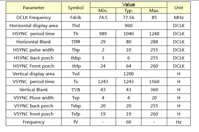

  • 1. The address of 948 on port1 is 0x30, the address of 948 on port0 is 0x2c, and the 948 on port1 is controlled by a single i2c, and port0 is controlled by 941 transparent transmission
    2. Screen timing is as follows: dual link lvds screen
    3. 0x67 is not written twice in the script. The two colons of "::" indicate that the line has been commented.
    4.The script wants to verify that 948 on port0 can be displayed first and then proceed to the next step of verification, but currently no single port can be verified and displayed, and finally 948 on both ports can be displayed;
    According to the relevant situation, what other suggestions? Thank you!

  • Hi Tony,
    1. The configuration of BRIDGE_CFG2 is set to 0x80(LEFT_RIGHT_3D) when soc source is used normally, and 0x02(internal reference clock mode) when pattern is used in 941 internal clk. Is this OK?
    This is OK. When the SOC source is used, the 941 will be using to DSI clock to generate the FPD signal. When the 941 PATGEN is used, the internal timing will generate the FPD signal.
    2. 948 cannot be locked after Set M=6 and N=31, so 948 on port0 cannot be displayed, but 948 can be locked when M=1 and N=2 are configured, and the screen has consulted panel fae to support 30fps. In theory, 100M pclk is fine
    Sounds good. I based my M and N values off of the panel datasheet. If the panel can successfully the pattern, the PATGEN is good.
    Jack
  • Sounds good. I based my M and N values off of the panel datasheet. If the panel can successfully the pattern, the PATGEN is good
    But M=1 and N=2, the screen is still black.
  • Hi Hongwu,
    Lock wasn't acquired with the M=6 and N=31 because the PCLK was set too high for single link. I adjusted the M and N values for a 30 FPS PCLK and tested this with a 941 and 948 to make sure that it would lock. Because the screen is designed for 60 FPS, I'm not sure if the screen will display correctly.
    Current PATGEN settings:
    • M = 5
    • N = 56
    • PCLK = 71.4 MHz
