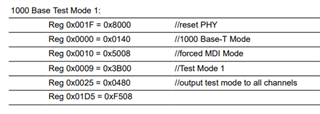

Hi
I have two DP83869HM connected to a AM6442. The schematic/BOM of PHY2 is a copy of PHY1 (except address and RGMII port)
PHY1 passed the Gigabit compliance test but on PHY2 the voltage levels of Peak A / Peak B  are far to low (about 590mV).
According to some other threads our magnetics could be wrong, but why is PHY1 passing the compliance test?
Are there any other known reasons?
Martin

  • Hi Martin,
    I had a look at the schematic. As you mentioned in your first post, you are using a center tap connected magnetic which does not meet the datasheet requirements. This is likely the cause of the compliance failure, and the solution would be to switch to a non-center tap connected magnetic.
    Just to check, are you using the script provided in SNLA239?
    Can you share the setup pictures as well?
    David

  • Hi Martin,
    Are you using a test fixture with 100ohm differential termination for this test?
    It is not expected to see this much variation in peak voltage between the two PHYs. Note that register 0x1D5 is an extended register so you must use the procedure shown in section 9.4.9.1 of the datasheet. Can you please verify that register 0x1D5 = 0xF508 in both cases before completing the compliance testing?
    Additionally, we have sometimes seen better compliance results when the test is run on only one channel at a time, rather than using 0x0025 = 0x0480 to output on all test channels. Can you please run the test with 0x0025 = 0x420 to output the test mode on only channel B?
    David
  • Hi David
    Testing one channel at a time with mode 1, 2, and 3 worked. Mode 4 was always one channel at a time. 1000 MBit/s is OK now.
    I have one issue with 100 MBit/s, the negative overshoot is 6,1%. Could that be the result of to short traces between PHY and connector?
    The official compliance test cable is only 6 inch long, if I use a longer ethernet cable the test is OK.
