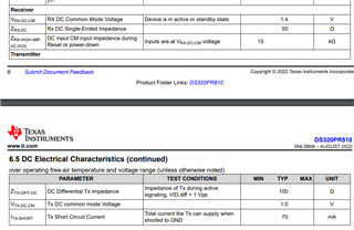

The description in the Datasheet of our DS320PR810 is a single-ended 50 ohm termination, but the current PCIe impedance is differential 85 ohm. Please help customer to confirm what they should choose when doing circuit design.
Hi Fabio,
Typically if it is a chip to chip design then 100-ohm interface is used. However, in Add-In-Cards when signals go through 85-ohm impedance, 85-ohm controlled impedance is used. Therefor this depends on the customer application.
