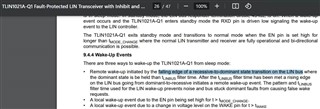

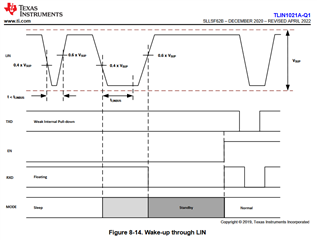

I would like to know whether TLIN1021A-Q1 could support specific pattern wake up or not?
According to datasheet description, whether it is okay for just to meet the falling edge of a recessive-to-dominant state transition on the LIN bus in this specific pattern?
Please advise!
