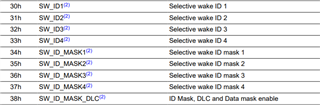

When set the TCAN1146-Q1 CAN_WAKEUP_ID as 0x500.
One question, when change the mode from normal to sleep. Will the setted CAN_WAKEUP_ID to  SW_ID3 Register and SW_ID4 Register save in some EEPROM?
I did not find the related information in the datasheet.

    The selective wake registers for this device will maintain their values while the device is in sleep mode. The Vsup supply is used to maintain some memory values in this low power sleep state so this information will still be lost if the Vsup supply is cycled. There is no way to save these values to non-volatile memory space. The selective wake configure should be re-initialized by the MCU any time the transceiver is going to be put into its sleep state.

  • I had already successfully configured the all neccessary registers with selective CAN ID 0x500. And successfully tested  the wakeup and sleep fucntion.
    Then I just remove the selective CAN ID registers configurations in the init function.
    //  // id[5:0]   =>  [7:2]
    //  TCAN114X_write(0x33, (CAN_WAKEUP_ID & 0x3F) << 2);
    //  // id[10:6]  =>  [4:0]
    //  // bit5: 0: 11-bit ID   1: 29-bit ID
    //  TCAN114X_write(0x32, (CAN_WAKEUP_ID >> 6) & 0x1f);
    //  // SW_ID_MASK4 mask[10:3]   =>  [7:0]
    //  TCAN114X_write(0x37, CAN_WAKEUP_ID_MASK >> 3);
    //  // SW_ID_MASK_DLC mask[2:0]  =>  [7:5]
    //  TCAN114X_write(0x38, (CAN_WAKEUP_ID_MASK & 0x07) << 5);
