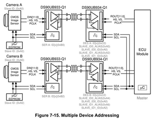

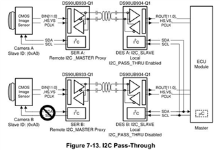

    As shown in Figure 7-13 below, the communication between SER A (DS90UB933-Q1) and Camera is through I2C. In the actual I2C communication, is SER A (DS90UB933-Q1) Master? or Slave?

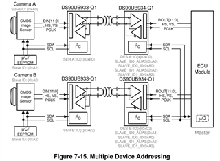

    Or as shown in Figure 7-15 below, uC (0xA2) is added to the I2C bus between SER A (DS90UB933-Q1) and Camera. In the actual I2C communication, is SER A (DS90UB933-Q1) Master? or Slave?
  • Hi Jimmy,
    Once the transaction passes across the FPD-Link to the 933, the 933 then acts as a proxy master since it will regenerate the I2C clock to send the I2C transactions to the imager slave device. Figure 7-15 is showing an example of there being multiple slave devices connected to multiple serializers. The SER is still the proxy master.
    Cindy
