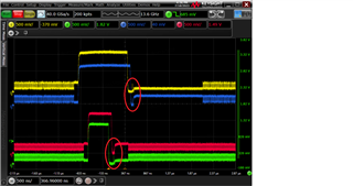

When we use the retimer to drive camera MIPI signal, the DB output will have peak as the capture shows:but when camera sensor connect to SOC directly, it does not have .
LP-->HS peak

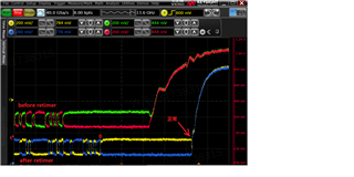

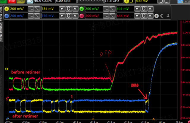

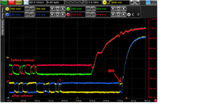

When the HS exit to LP,the THS-skip window has a bit flip.
bit flip 1
bit flip 0
