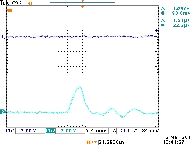

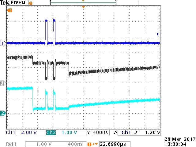

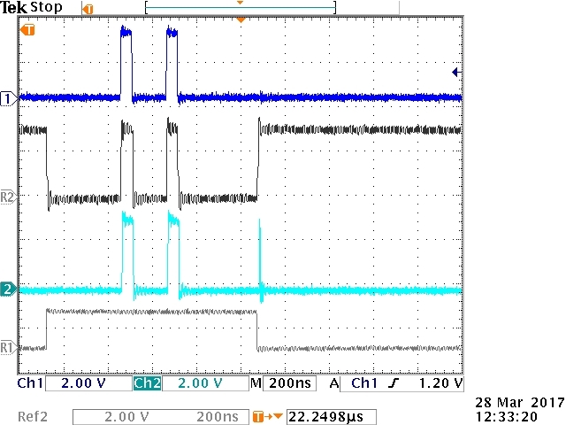

  • I am having the exact same problem as Luis. I am using the 65MLVD206 and tried briefly with the 65MLVD201 to see if it was better. My setup has a transmitter at one end (switched on and off via TE), 10 cm of transmission line, and a receiver at the other end. *RE is tied low at both ends. Each end has a 100 ohm terminator.  I need R at the receiving end to look exactly like D at the transmitting end. I will show you what I found on the scope:
    1: signal at D on transmitting 65MLVD206
    R2: signal at R on receiving 65MLVD201 (not really usable)
    2: signal at R on receiving 65MLVD206 (this has the glitch when TE is turned off)
    R1: signal at DE on transmitting 65MLVD206
    Zooming in on the glitch on the R line (the bottom trace):

    From this you can see that the LVDS signals behave. When TE is turned off, the B signal rapidly drops, and the A line moves up slightly but still B>A so we should not see a 1 output.
    It seems if I go to a 50 ohm termination instead of 100 ohm the problem goes away. I can also bias as Luis did, but it seems something is fundamentally wrong. I want a robust solution, and I fear this is a band-aid solution.
    Are you able to explain what is happening? Does the receiver have some inductance such that when B drops rapidly with A rising that it sees this as a 1, even though the voltage levels don't justify this?
