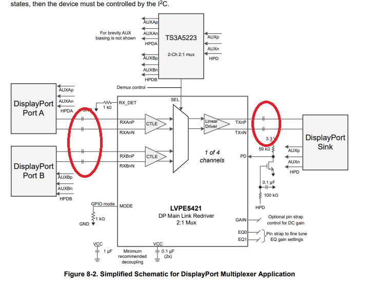

For datasheet 8.2.2. this application, does it need both in/out AC capactitor?

You need to place AC cap on either side of mux. You need to bias AUX channel as well.
