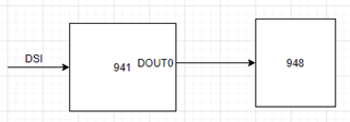

DS90UB941AS-Q1: How to config register to connect 948 with DOUT0?
Part Number: DS90UB941AS-Q1

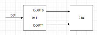

I previously used DOUT0 and DOUT1 to connect 948.

Now I need to use only DOUT0 to connect 948
but failed with the original register configuration.

  • Hey xuefei,
    When you say failed you mean you don't see video lock between on the Des side? Do you see link established between Ser and Des, does I2C work locally and remotely ?
    Do you have both Ser/Des set to the correct mode straps? Coax Vs. STP ?

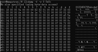

    Can you provide a register dump of your non-working system? What PCLK is used here?
    This is the register dump.

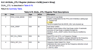

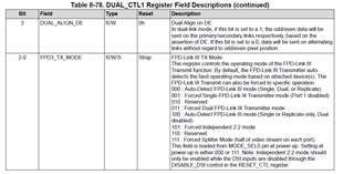

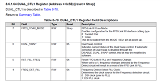

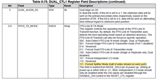

  • Hey xuefei,
    Register 0x5b is set to 0x87 which is forcing splitter mode. This won't work for a single lane connection. Also, this is a Coax system?
    If it's a coax system you need register 0x5b to be set to 0x81
    board.WriteI2C(Ser_addr,0x5B,0x81) #Forced Coax config and Single FPD-Link III Transmitter mode (Port 1 disabled)
    Fadi A.
  • Also, this is a Coax system?
    This is a twisted pair system.

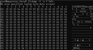

  • I tried configuring the two registers 0x5b and 0x4f, but still can't establish connection.
    This is new register configuration.
