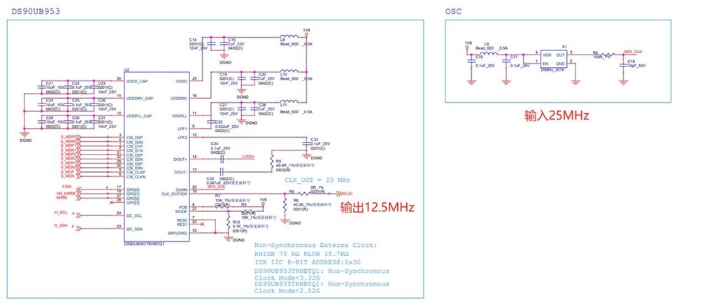

Hi
My customer are seeing Horizontal line noise, and resolution not stable issue as the attached video show. may i have your suggestion how to debug the issue ? thanks!
the target resolution is 1920*1423 @ 30 frame per sec.
customer schematics as below
video of the issue
  • Hello Pytsal,
    I will review the schematic and get back to you. In the meantime, can you answer the questions:
    • Is this a single or multiple device issue?
    • How often can the issue be reproduced?
    • What is the paired DES? What is the clocking mode? Synch or non-Synch?
    • Does digital resetting the SER heals this issue?
    • Does digital resetting the DES heals this issue?
  • Hi Hamzeh
    answer as below
    1. Multiple device got the issue
    2. the issue can be reproduced every time
    3. the pair DES is DS90UB94
    4. Does digital resetting the SER heals this issue?-   NO
    5. Does digital resetting the DES heals this issue?    NO
  • Hello Hazel,
    Multiple devices out of how many tested/produced?
    not sure what device is this?
    Additionally, can you provide register dumps from a suspect system and from a good system, from SER and from DES?
  • Hi Jaradat,
    1. customer build 3 PCB, all 3 got this issue
    3. the DES is DS90UB954
    DS90UB954 register dump as below (the suspect system)

    customer do not have register dump for the good system, since all the 3 PCB got issue
  • Hi PY,
    Can the initialization script also be provided?
    Does the failure follow the SER or the DES (which system is the 4 failures)?
    If PG is sent from the SER, does this issue still occur? If PG is sent from the DES, does this issue still occur?
    Logan
