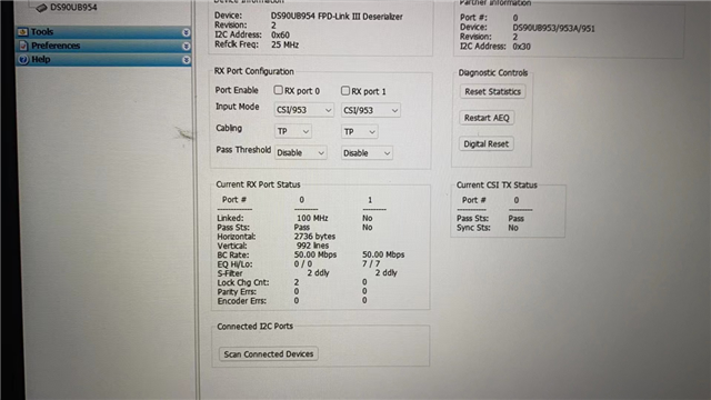

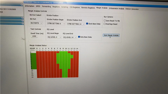

Customer use MAP tool to verify the link signal integrity and result showed below. There are two questions below:
  1. They test serval times and only first time failed, others are pass. Does this influence? Is there possibility the MAP tool bug cause first fail?
  2. Does MAP tool pass mean signal chain integrity are OK to use? If customer still found image error, any more methods or register need to be checked to debug?
Thank you!

  • Hi Marc,
    If the results are similar across several tests, the first test result could have been impacted by the hardware or software setup.
    MAP tool passing specifically denotes passing link margin between the serializer and the deserializer. The link margin may be impacted by several characteristics such as PoC noise, and Channel specification limits. Margin Analysis Program runs by monitoring register 0x4D and 0x4E on the deserializer.
    If an image error is detected, additional status registers can be read for debugging. These registers include CSI-2 status registers on the serializer and deserializer. An example of registers on the deserializer includes 0x55, 0x56, 0x7A, 0x7B. Serializer registers include 0x49, 0x52, and 0x5D-0x60.
