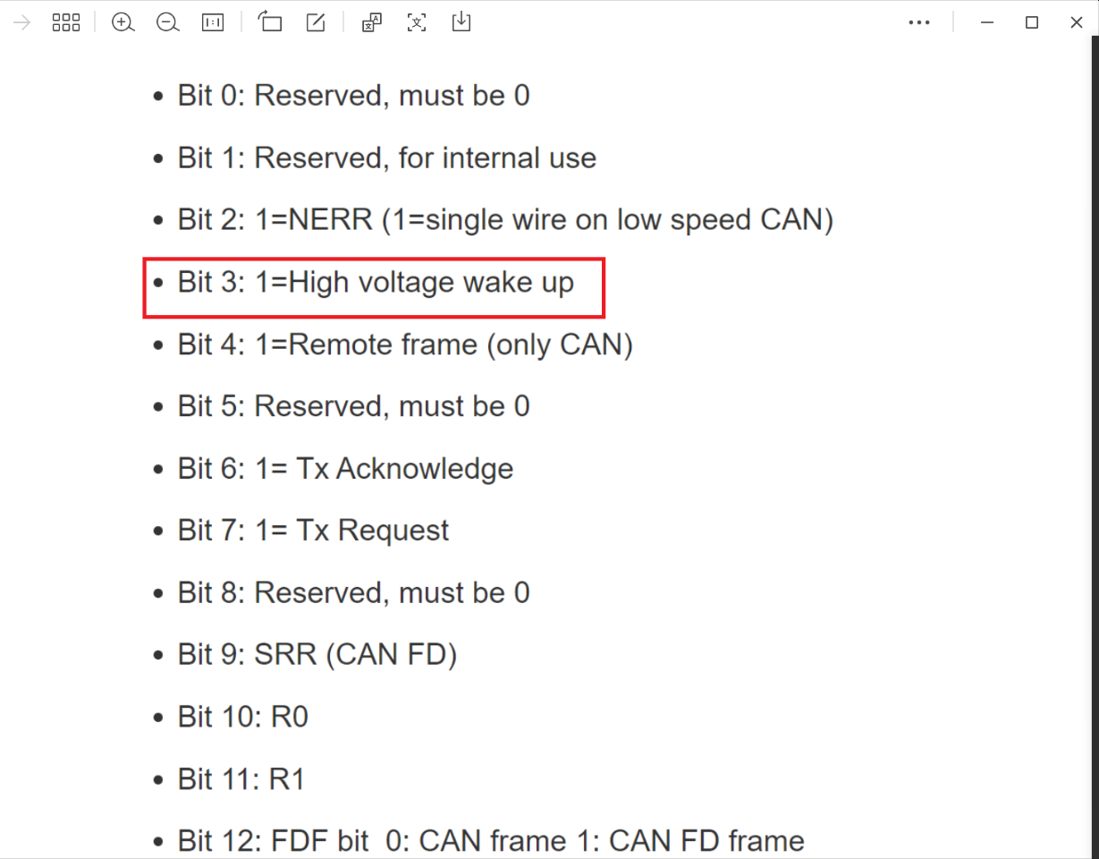

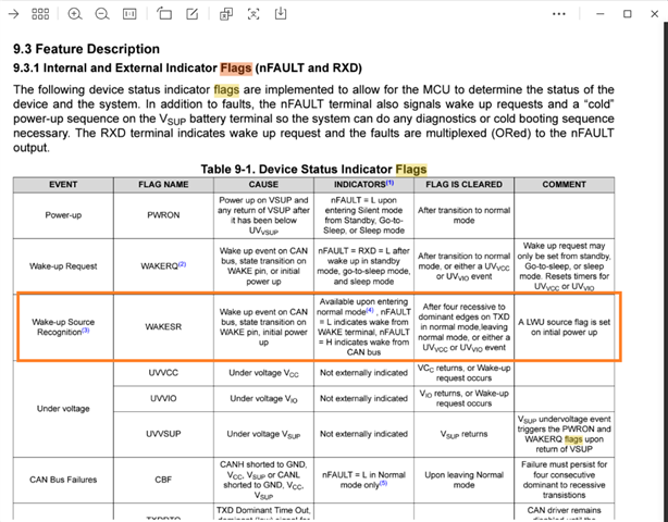

We use TCAN1043-Q1 have question:
about CAN Frame flag Bit[3]: High voltage wake up related with LWU status?
so we need CAN transceiver(TCAN1043-Q1) setting Local Wake Up(LWU) ? could be change TRUE status?
if any suggestion, Please advise me.

    The flag you're referencing is active when a wake-up occurs. If it is a LWU on the high-voltage input WAKE pin, then nFAULT will be LOW. Otherwise, nFAULT will be HIGH.
    What is the third image that you've posted? Shown here:
