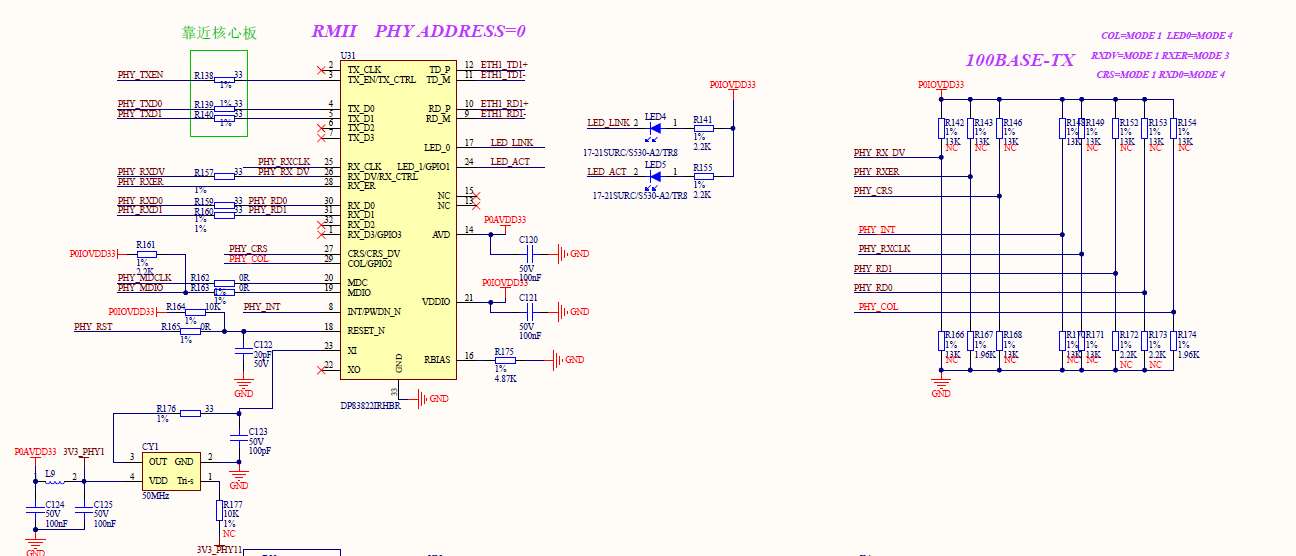

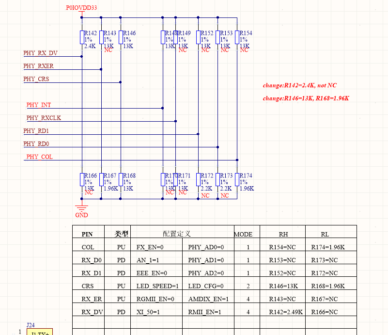

  • Hi Cherry,
    Here are my comments on the schematic.
    1. The strapping doesn't look as expected. From the schematic, customer want to use RMII mode with PHY Address 0.
      But RX_DV is not set into Mode 3.
      The description of modes of straps in the schematic doesn't match the requirement and what is implemented in the schematic.
    2. LED_1 should not be active low LED, unless it is strapped to Mode4. I see from the logs, LED_1 is strapped into a mode which should not be used.
      I suggest depopulating connections on LED_1
    3. Please check if the PHY needs to be in RMII mode or RMII_50 mode and configure straps accordingly.
    Gokul.
  • Hi Gokul,
    For comments #1 and #3, the customer have determined that the PHY requires RMII_50 mode and that RX_DV has been configured for mode 4 (the modifications are not made in the schematic).
    For comment #2, they don't have a need for an LED so it can be ignored for now.
    Thanks and regards,
    Cherry

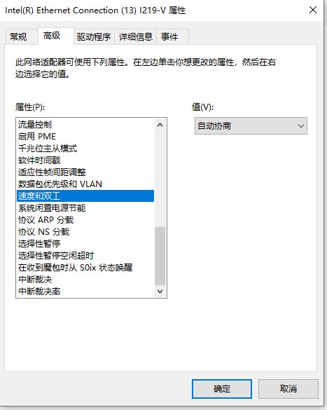

  • Hi Cherry,
    While you were sharing the logs of registers 0x0467, 0x0468, I noticed some errors which led to wrong conclusions on the strapping.
    Upon detailed look at the values of registers 0x0467 and 0x0468, I see that the values are a mirror of registers 0x0007 and 0x0008. This means that the extended register access is not used correctly.
    To read registers 0x0467 and 0x0468, can you please ask customer to following indirect access as outlined in section 8.4.2.1 of the datasheet?
    With all these, I feel that the strapping is fine except for CRS pin where the registers are not mounted appropriately. Please ask the customer to correct the pull up and pull down resistors on CRS pin. This wrong resistors on CRS pin should not affect the link-up, but the issue is somewhere else.
    From the logs, I still see that link partner is not advertising 100M full duplex. Please refer to register 0x5 description.
    To isolate whether it is a DP83822 issue or the Link Partner issue, can you please connect ETH0 and ETH1 ports and share the logs of 0x00 to 0x1F, 0x0467, 0x0468 registers?
    Otherwise, you can carry out the experiment with linking up two boards of DP83822. Sharing logs with this setup also works.
    Gokul.

  • Hi Cherry,
    I see that this thread has gone silent so I will be taking over. There has been quite a bit of back and forth and I want to be sure that I'm understanding the setup and issue correctly. You are able to communicate in 10 Mbps but the goal is 100 Mbps, where you are currently seeing packet-loss.
    Generally in Debugs the first step would be what Gokul mentioned above:
    1. Read Registers 0x0467 & 0x0468. The purpose of doing this is to confirm that the PHY is in the correct Mode.
      1. The following FAQ provides more details as to how these registers might be affected
        1. How to Confirm Ethernet PHY Strapping
      2. As Gokul mentioned before, both of these registers are Extended Registers and cannot be read directly.
        1. This FAQ provides more details on how to perform extended register reads
          1. Extended Registers
      3. Has the Schematic been updated to reflect the strap settings? Below is our schematic checklist that can be given to the customer
        1. The Pin-wise Checklist tab will help with pin connections
        2. The Straps Tool tab helps choose the correct strapping resistors to achieve the correct mode.
        3. Please note that Orange Boxes are drop down menus that can be selected
          1. https://e2e.ti.com/cfs-file/__key/communityserver-discussions-components-files/138/0243.DP83822_5F00_Schematic_5F00_Design_5F00_Review_5F00_Checklist.xlsb
    I apologize if it feels like you have already gone through these steps, but I want to be sure that PHY settings are correct. If the PHY is in the wrong mode, it'd be no wonder that it is misbehaving.
    Alvaro
