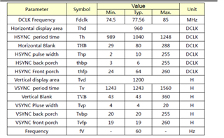

1.panel timing:
2.

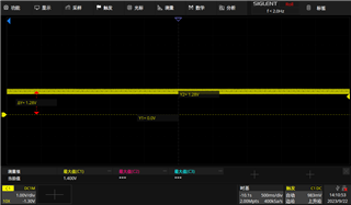

I used the 941AS splitter mode but could not output the picture.
my script configuration is shown below,Please check whether the configuration is correct

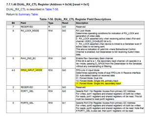

    Why are you using secondary input on Des side? Is Dout1 of 941AS physically connected to RIN1 of Des ?

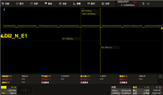

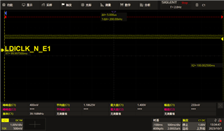

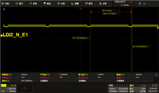

  • 1.What is the issue here, are you seeing  black screen on both displays? Did you try testing with Patgen first?
    yes,all the screens are black.I try testing with Patgen  but  the screen is still black.
    my script pattern configuration is shown below.I try let screen on port0 to display.please check it.

    2.What is your superframe PCLK frequency?
    4000*1243*30=149,160,000

    4.Why are you using secondary input on Des side? Is Dout1 of 941AS physically connected to RIN1 of Des ?
     Dout1 of 941AS physically connected to RIN1 of Des.Use a separate i2c for control.
    Is there a reason you're not using the primary input RIN0?
    If you are using RIN1 then you'd need to force that in Register 0x34 locally on 948 side otherwise it won't work.
    Basically you need to write 0x19 to register 0x34 to enable RIN1. You need to do this with a local I2C connection to the 948 side otherwise it won't work.

  • We measured and compared the waveforms of FPD Link III between this device and other project devices. They roughly look the same. How can we tell whether the FPD Link III signal is valid? Are there any examples or standard waveforms? The difference we can see is that there is a difference in the timing of the LVDS signal output by the UB948. Is this the root cause of the no display on the screen of the device?
    Below are lvds data lane waveforms that can be displayed normally on other items.
    Below is the lvds data lane waveform currently being debugged

    • The screen backlight is good, the power supply is good.All I can think of is panel timing,but hactive and vactive is correct. And how do I check the panel blank?That's the only doubt I have
  • Hi Hongwu,
    Since the doubt regarding the information making it to the DES is removed, I think this step probably isn't needed.
    Is this display brought up in any other system/program? Is this the first time the display is brought up with FPD-Link?
    Panel blanking will need to be checked with the display module vendor or display system supplier. Maybe one of the above blanking parameters is being misinterpreted (HS included in HFP, etc).
    Logan
  • I'll grab a 941PG lvds waveform later.
  • Dear Logan,
    Below is the lvds waveform diagram of 948 output that I captured.Please help to check whether it is correct.
  • Hi Hongwu,
    The OLDI CLK and output look valid. This looks more so to be potentially a video timing issue (video blanking, polarity, etc) as indicated before. Maybe there is a PCLK, Htotal, Vtotal, polarity, or other video timing parameter being violated as currently programmed into PG of 941. The probed OLDI signals and resolution detection readback prove that 948 appears to be operating correctly.
    Are you sure the display panel can accept 30fps? It directly specifies 60Hz in datasheet table.
