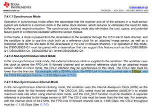

In Non-Synchronous Clock Mode mode, why is the FPD-Link III forward channel rate 3 Gbps in the case of an external crystal oscillator of 52Mhz? Instead of 52x80 = 4.1Gbps? In addition, can a crystal oscillator greater than 38MHz be 3Gbps?
I have a sensor with an output of 200M raw8, a mipi output of 438Mbps/lane, using UB90ds954 in Synchronous Clock mode, the picture is stuttering,
but switching to Non-Synchronous Clock Mode mode, using a 48Mhz crystal oscillator, only half of the image can be output, and the other half of the image is blurry
However, in Non-Synchronous Clock Mode, the image can be output normally at 54Mhz,I suspect there is something wrong with this 3Gbps setup calculation? In addition, in synchronous mode, how can the fc rate reach 3Gbps?
  • Hello Renf,
    Because this device has max supported CSI throughput = 2.528Gbps which is 3Gbps of forward channel data rate.
