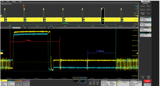

    4.3: the customer do not have a DSI analyzer and they use an oscilloscope to capture the waveform of lane 0 as follows:

  • Hi Cherry,
    It looks like the LP-11 transition is happening during the HFP. The DSI source may not have enough time to transition between HS->LP->HS between ending the video line long packet and sending the HSS packet.
    This can be used as a potential solution:
    Can you probe the HS/VS/DE signals that the 941 is receiving? Once the data has been collected send the saleae capture.

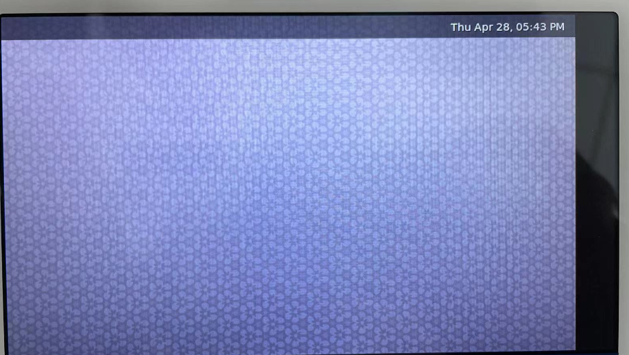

  • Hi Casey ,
    Appreciate your feedback and support here!
    Without modifying the DSI source, the customer has modified some of the contents in the drive of 941, combined with the register modifications provided, and can now successfully illuminate the screen using the DSI.
    However, the picture of the screen is shifted all the way to the left, and there is a black block on the right, as shown below:
    The same screen used the same timing on the sn65dsi83 and the picture is normal. The DSI input source for both devices also remains the same.
    The problem can also be corrected by adjusting the HBP value to large in the device tree as follows:
    The customer would like to know what could be causing this? Is it due to there is some difference in resolution between 941 and sn65dsi83?
    Thanks and regards,
    Cherry

    The expected HBP is 40. What is the modified HBP?
    Gil Abarca
  •  Hi Gil Abarca,
    HBP value used on sn65dsi83 is 40 and modified HBP on 941 is 92 to display in the correct location.
    Thanks and regards,
    Cherry
  • Hi Cherry,
    Based on the image shared in this thread the LP-11 transition might be happening during the HFP. The expected blanking parameters are HFP = 40, HBP = 40, and HSW = 48. There still could be some HFP but not 40 pixels as expected or enough pixels to meet the blanking requirements of the display. Therefore, by adding that missing blanking to the HBP it compensates the total blanking required by the display.
    Gil Abarca
