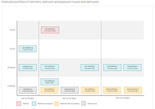

Do we have mux support PCIE Gen5?
Nison
Hi Nison,
At this point, we don't have passive mux with bandwidth for PCIe gen5. However, we have redrivers with MUX/DEMUX capability and crosspoint capability. Please see portfolio overview below.
