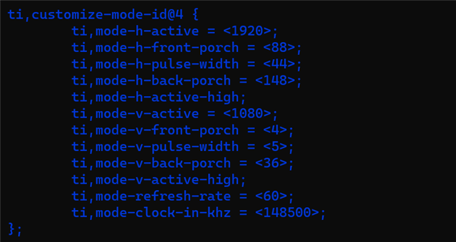

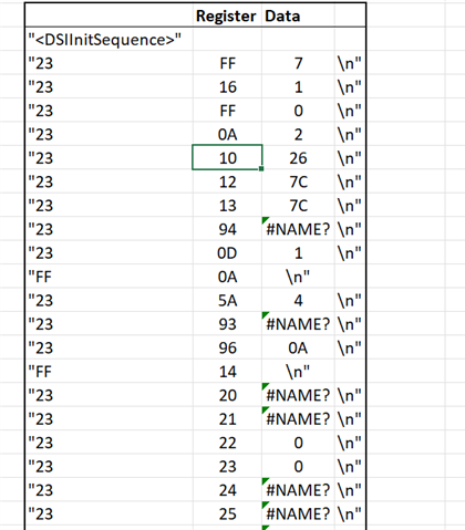

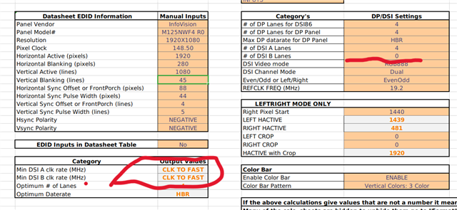

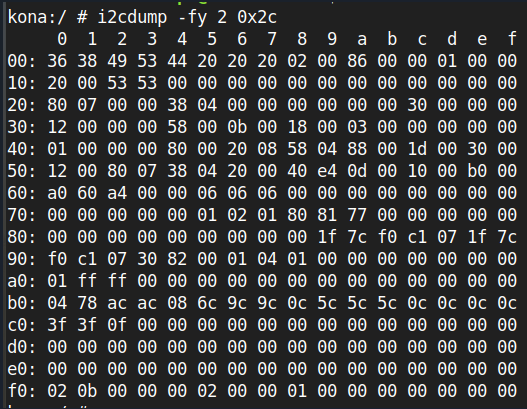

Hello support team,
We are evolving the DSI-eDP EVM.
We have a QCS8250 base from where we are using the DSI source.
Initially, we are testing the 1920x1080 resolution. and we are able to get the test pattern by updating the 0x3c register. But the DSI video is not appearing on the panel.
Can you help us get a resolution? Where do we need to check, and what extra settings do we need to write?
