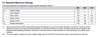

    The absolute maximum rating for storage temperature can be found in section 6.1 of the datasheet on page 5. Going above this temperature >150C could potentially cause permanent damage to the IC, and the device may not function properly after violating the spec.

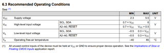

    The max and min operating temperature is listed in section 6.3 underneath the section "recommend operating conditions" on page 5 as well.
    Violating these temperature specs simply implies that the electrical specifications are no longer guaranteed if you decide to operate the IC below or above the min/max recommended operating conditions. It may or may not cause permanent damage to the device. Permanent damage to the IC is more closely determine by the abs. maximum conditions in the datasheet.

    PCA9548ADB inside the heat chamber without power is applying the storage temperature spec. As long as the ambient temperature is not below or above the absolute max conditions in the datasheet for storage temperature, you are guaranteed that no permanent damage occurred to the device.

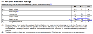

    ANOTHER thing to keep in mind is that the maximum ICC current through the device should not exceed -100mA to 100mA. This is found in the abs. max conditions.
    Adding excessive ambient heat as well as operating the device max cause a significant rise in ICC, IO, II abs. max specs which could potentially cause permanent damage to the device if these specs are violated. Please be sure that the temperature you are testing the PCA device at is not causing the current to rise/fall above/below the min/max specs of the device. Otherwise, permanent IC damage could occur.
