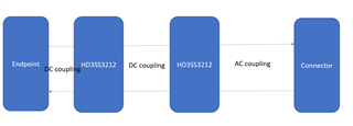

I have two HD3SS3212 are daisy chained and isolated from the surroundings using bypass capacitors on both RX and TX high speed lanes.
The two are biased to GND on the A0 and A1 ports.
The design is a USB3 5Gbit/s switch.
Is it necessary to isolate them using bypass capacitors in between and new bias resistors to maintain signal integrity?
We have problems with signal quality even though we have done the layout correctly (as we know it) and use a high quality pre-preg for high speed.
    Can you please share your block diagram or schematic? I drew a rough block diagram on how to AC coupling two HD3SS3212 as shown below. The block diagram assumes the endpoint common mode voltage meets HD3SS3212 common mode voltage requirement.

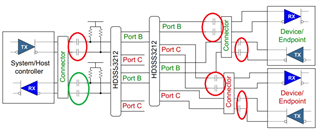

  • I cannot show the exact details of our design but with some cutting from the documentation images I have added below a simplified schematic of what we have implemented. The PortC on the first HD3SS is going to other functionality to implement a multi port switch. The path shown below is an example of what is problematic for us.
    The bias resistors are connected to ground as it is stated that GND is a valid bias for the chips.
    I have tried to patch 1.5V bias with no change in behaviour.
    The problem we see is bad connnection on some USB3 hosts and OK connection on some. We have a PassMark USB3 looptest device to test for bit errors and throughput which indicates bad connection.,

    What is the value of the capacitor? The USB spec has the capacitance of min 75nF and max 265nF. So you want to make sure the total capacitance(capacitor at both side of MUX) stays within this range, otherwise you will have DC wander issue.

  • The capacitors is 220nF. I have also tried 100nF and 470nF as the far end might have capacitors as well.
    I can add as a feedback that I did not find information of the probably best option to use 220nF caps in the case the host or device also has caps in the signal path. The datasheet says to use 100nF. I found this information first when reading the documentation of the development board of yours.

  • Hello:
       Just one more question, do you have the same AC cap value on both TX and RX? RX AC cap value should be >300nf.

  • I have the same value on all 8 positions. Do you have a reference for the need of using >300nF on RX?
    Also; can you define what you mean by "on RX"? Do you mean on both sides of the daisy chained chips on the SSRX diff pair or do you mean on the ingress side of both diff pairs of SSRX and SSTX?
    To be very clear you could edit the image above and draw a ring or arrow of the capacitors you think should use >300nF.
  • Hello:
                the green color on SSRX should be >300nf, the red color can be 220nf since there are two caps on SSTX host side.
    Did you try to remove bias and  AC caps close to host side?
    Regards'
    Brian
  • Thank you Brian
    Yes, I did try to remove the caps and bias resistors with no obvious improvement in bit error rate. As this was after I had access to the proper instrumentation I could not tell by the shape of the eye-diagram if a measurable improvement had been accomplished.
    My guess right now is that I have done what I can except for adding signal conditioning to compensate for the attenuation in my board. That is partly why I would like to get hold of the datasheet of the chip on the host board to see if it requires the device to bias the diff pair to something higher than GND or at all.
