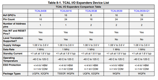

Hi Sean,
The MCP23S08T is the SPI controlled IO expander while the MCP23008 is the I2C controlled IO expander.
Our team does not have a SPI controlled IO expander, but we do offer I2C controlled IO expanders.
Here is a list of our 3.3V IO expanders of our newest silicon.
If the customer has a 5V application, consider the TCA version instead of the TCAL version.
i.e.
TCAL6416 is 3.3V
TCA6416 is 5.0V
