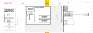

We're developing a test application to generate a maximum busload on DS90UB954-Q1:
This test app checks whether DS90UB954-Q1 can run with the maximum busload.
My idea is: set max resolution and max fps on camera to have the max busload this board can generate and run through the DS90UB954, this case only generates the max busload that our board can generate.
But if like this, we can not generate the max busload on the datasheet of DS90UB954
So Could you guide me:
1. What is the maximum busload of DS90UB954?
2. How to generate maximum busload on DS90UB960 De-Serializer
3. How to calculate % busload
Thank you very much in advance!

  • This is my system:
    I use the camera with: sensor is IMX490, serializer is DS90UB953
    Do you have any example for this test app. If yes please share it, I really appreciate it!!
