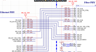

We have an ethernet card design that uses 2x DP83822IF configured in MII to accomplish MDI copper to MDI Fiber media conversion from a PCIe MAC.
The MAC and system processor do not have access to MDIO registers, so configuration of both DP83822 PHYs is done purely through HW bootstraps.
I have achieved successful, repetitive link-up @ 100Mbps and wanted to validate the stability of the MII link by doing an infinite ping test and monitor the packet loss.
Everytime, i get around 2-3% packet loss (out of thousands, sometimes thens of thousands of pings).
Our configuration is as follows :
Copper PHY
100Base-TX full-duplex, no MDIX, no autonogetiation, MII 25MHz, SD disabled
Fiber PHY
100Base-FX full duplex, no MDIX, no autonogetiation, MII 25MHz, FX enabled, SD enabled
Copper PHY <-> Fiber PHY MII Media converter connectivity:
TXD[0..3] -> RXD[0..3]
RXD[0..3] <- TXD[0..3]
TX_CLK -> RX_CLK
RX_CLK <- TX_CLK
TX_EN -> RX_DV
RX_DV <- TX_EN
RX_ER, CRS and COL are not shared connections between both PHYs.
The 25MHz clock between both PHY is shared, I.E one cmos oscillator that feeds both PHY. It is in spec with the minimum requirements for the DP83822IF (25MHz, ±25PPM).

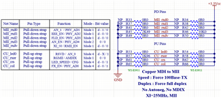

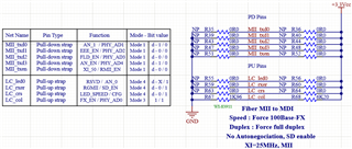

Our strapping for both PHY is as follows, and as said previously, this works fine, we have a consistent link-up and disconnect through signal detect, and the network adapter in windows follows the state of SD.

  • Hello Melissa,
    Find attached a schematic snippet of how both PHYs are connected together.
    We do not have access to the MDIO bus on this card since it's a hard-wired, 100Mbps full duplex media converter application. Thus I cannot read the register @ address 0x15, but my guess is that would the RX_ER counter register.
    Our setup is :
    PCIe MAC i210IT <-> PCB CU MDI <-> DP83822IF CU <-> MII <-> DP83822IF FX <-> PCB FX MDI <-> FX transceiver
    The DP83822IF CU is configured as such:
    Forced 100Base-TX, force full duplex, no MDIX, no autonegotiation, MII 25MHz
    The DP83822IF FX is configured as such:
    Forced 100Base-FX, force full duplex, no MDIX, no autonegotiation, MII 25MHz, SD_EN enabled, FX_EN enabled

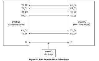

  • Hi Jean Francois,
    Apologies, I was mistaken. You can connect the PHY's MII to another processor's MII interface, but I do not believe you can do a back to back configuration like the one above.
    Both TX_CLKs are being supplied to each other at the same time, which is what may be causing your 2-3% packet loss.
    We suggest using RMII repeater mode instead. You can read more about how to configure the 822 in RMII repeater mode here:
    https://e2e.ti.com/support/interface-group/interface/f/interface-forum/1276229/faq-dp83822i-how-to-use-rmii-repeater-mode-in-dp83822?tisearch=e2e-sitesearch&keymatch=rmii#

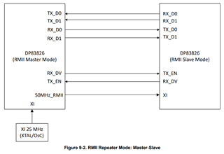

  • Hi Melissa,
    Thank you for your response.
    Quick questions in order to prepare this test:
    1) In this case, the RMII "Master" would be the one that is interfaced to the MAC through MDI, or the one interfaced to the fiber transceiver (DP83822IF CU would be the master PHY, and DP83822IF FX would be the slave PHY) ? I assume the master would be the CU phy
    2) What should I do with unused pins for RMII? (TX_CLK, RX_CLK, TXD2, TXD3, RXD2, RXD3) ? Leave them floating?
    3) The master PHY will automatically output a 50MHz clock on RXD3 based on HW strapping, which should then be connected to the XI input of the slave PHY, correct?
    4) The strapping for the XI input shall be as shown below, M being master, S being slave, correct?
    Thank you and I'll try to test this as soon as I have your valued feedback.
  • Also in this connectivity scheme, when the FX PHY fiber is disconnected, how is the far end fault propagated to the CU PHY? Since the CU PHY provides the clock to the FX PHY, what mechanism is put in place to make sure they both stay synchronized?
  • 1) It doesn't matter as long as the XI and CLK connections are correct. You can have one 822 as a slave and one as master, or they can both be slaves. Refer to the diagrams below.
    2) Yes, you can leave them floating.
    3) You can do this configuration. Refer to the images above.
    4) Yes.

  • Hello Melissa,
    First, thank you very much for your valuable help in this matter.
    My problem has been resolved.
    Using RMII repeater with shared 50MHz clock between PHY, no more packet loss with more than 10k+ pings and counting.
