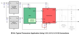

  • Danny,
    Thanks for your support about OVP. Customer don't have any problem about that.
    But there are some other problem customer feedback to me.
    1.Our device peforence well in 500KHz, while there ia some bit error when the device works in 1MHz.
    2.Customer connect 4pcs TCAN1057 in parallel with a computer host communication module. They need to change the sampling timing otherwise the board is unable to establish connection with computer. But they test TJA1057 from NXP, the problem isn't exist.
    3.Customer use 4pcs in their board in parallel and they works ok. But if this board connect with other board they can't establish connection.
    This is their block diagram and schematic. Do you have any advise to them?
  • Minghao,
    Could you have them try and measure the impedance/resistance between CANH and CANL when the bus is assembled? CAN transceivers are expected to transmit/communicate across a nominally 60 Ω differential impedance, so I want to make sure that it's at least above 50 Ω. Can you confirm that the 120 Ω resistor R39 is only present on one board and that only one other board (maybe host module) has the additional 120 Ω termination?
    An image of the waveform (CANH and CANL) would be very helpful for us to diagnose what's going on. The TCAN1057A-Q1 is not a digital device, so it is best for us to look at the analog signals so that we can diagnose what's going on.
    Danny

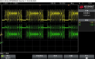

  • Hi Danny,
    For the termination resistor, I will recommend customer to have a test.
    And following is waveform. The first photo is TI TCAN1057 waveform.
    The second is NXP TJA1057 waveform.
  • Minghao,
    It looks to me that there is a significant ringing problem on their network. Try zooming in a bit on one of the bits - I would imagine that the VOD does not settle until very far into the bit. This is the case for both images you showed (NXP and TI).
    If your customer has a very messy network that causes unreliable communication for the TJA1057 and TCAN1057A-Q1, I would consider using the TCAN1462-Q1 signal improvement capable (SIC) transceiver, which can help with ringing on the dominant-to-recessive edge of the signal, which is where ringing is usually the most impactful.
