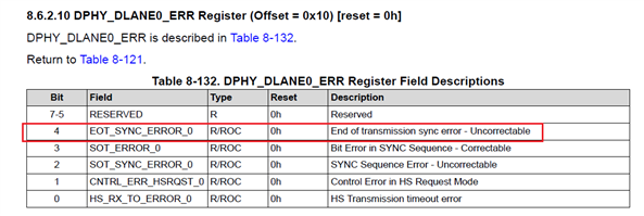

For step4, Multiple attempts were made using the SoC's DSI data and clock and the screen still does not turn on. The DSI output is configured for video mode, burst mode, continuous clock mode. Through oscilloscope, it can be seen that the DSI can output normally. However, after the register configuration is performed, the screen still does not work. Checked DPHY related registers 0xF,0x10,0x11,0x12,0x13,0x14,0x15, status register values of all four data lane are 0x14 = 0001 0000, where bit4 are indicated with errors:

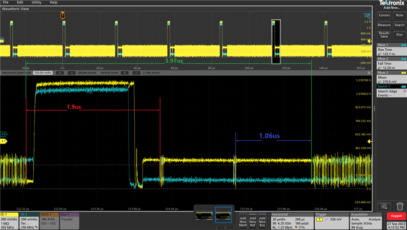

For step3, After configuration, DSI_VC_DTYPE reads as 0x3e.
And use an oscilloscope to capture the waveform of lane 0 as follows:
1) Dose this error indicating the SoC's DSI output is not configured correctly? Or what else error?
    Yes, this needs to be resolved from the DSI source side. The 941AS takes DPI timing directly form the DSI stream. The DSI standard mandates that the source must provide accurate DPI timing to the sink which is not happening here for all the blanking parameters in the horizontal  portion.
