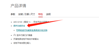

Is there a functional design for TCA9539-Q1? How is it realized?
The description in the chip feature description provides functional safety, does it mean that the TCA9539-Q1 has a functional safety related design?

See the Functional safety page.
"Functional Safety-Capable" means that you get FIT, FMD, and pin FMA; see the TCA9539-Q1 Functional Safety FIT Rate, FMD and Pin FMA application report, which is linked from the TCA9539-Q1 web page.
