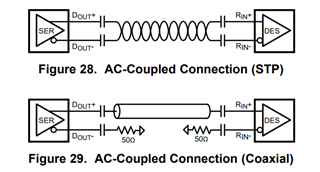

    Also one clarification i need is SMA  connector impendence is 50 Ohm  while LVDS impedance requirement is 100 ohm.
    so how connection from SMA connector will work, it is like two SMA connector connection will make for 100 ohm LVDS connection.
    Correct, SMA connections should be terminated at 50-Ohm impedances, and the LVDS are differential should be met with 100-Ohm impedances as well.
    Here is a diagram from the Datasheet:
    I hope this helps!
