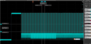

      I met one black issue:
    LP11 is ok, and the registers about DPHY don't report errors, DSI_VC_DTYPE is 0,
   two questions:
   1. Dsi receiver initialization must be finished in the host dsi startup P11 stage, or can do it in every P11 stage in host dsi output video data?
   2. Can 941 power up and initialize before the host DSI initialization, while only focusing on receiver initialization?
  • Hi Chen,
    According to DSI v1.3.1 specification, a DSI source is required to periodically enter LP11 (Low Power Mode) on the data lanes (not the clock) at least once per frame.
    Please see DSI bring up guide attached.
    7624.DSI Bringup Guide.pdf
    For deterministic start-up please follow datasheet power-up sequence recommendation section "10.2 Power-Up and Initialization" page 148 - DS90UB941AS-Q1
