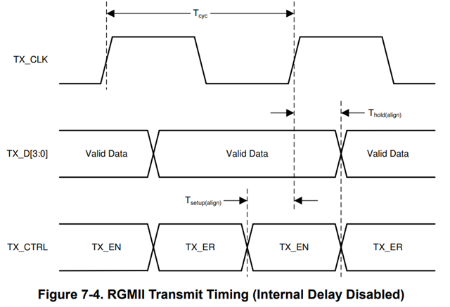

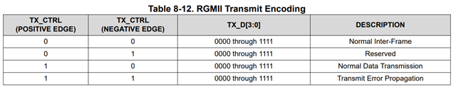

Could you explain more details about the below table 8-12 in DP83TC812S-Q1 datasheet under RGMII mode?
We notice the TX_CTRL pin will keep high during transmission.
From the datasheet, it seems that the TX_CTRL will pull high before TX_CLK positive edge and pull low before TX_CLK falling edge during normal transmission.
Or actually the "POSITIVE / NEGATIVE EDGE" is not refer to the TX_CLK signal?
Wondering the behavior of TX_CTRL pin during normal and error opeartion.
