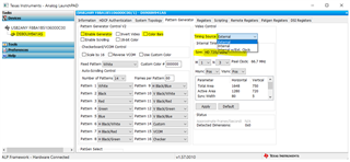

I'm using a DS90UB941AS-Q1 sererializer combined with 2 DS90UB948 deserializer.
In this example the serializer is configured in "independent mode" and there's 1 JEIDA/HDMI adapter appended on the deserializer
on port0.

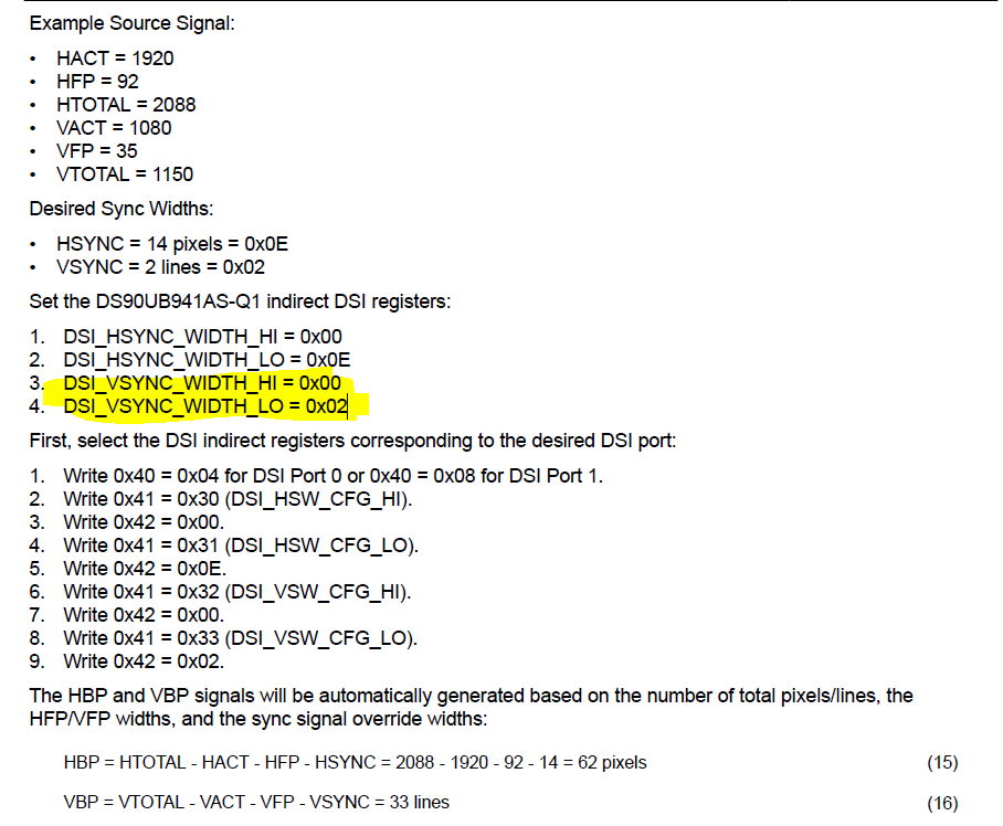

DSI input is configured to use Non-Burst Mode with Sync Pulses but I have a problem on the OLDI signal after the deserializtion.
Problem is the VSync pulse signal is always low and HSync is moving high. They look like this:
Expected signals:
Inizializatoin sequence:
