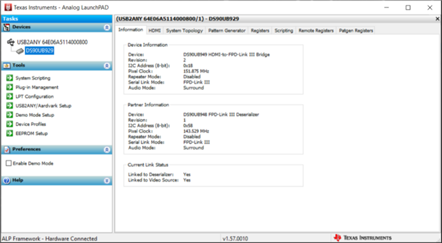

Hi E2E Team,
We are using the DS90UB949-Q1EVM for the automotive display application. When feeding HDMI input to the EVM board and the other side DS90UB948 with display is connected, but no picture on screen. If the same HDMI input is connected to the monitor able to see the picture.
Sathish.
