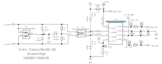

Hello!
I have the following schematic to review, please let me know if there is anything of note. I will be doing the review in parallel.
Thanks!
Nikola

Nikola,
Looks like the split termination is DNP so this is fine as a non-end node.
The decoupling capacitors are present and look to be appropriately valued.
It's also great to see that ESD2CAN24-Q1 is included in the protection socket.
Please let me know if any other questions arise!
