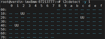

Now that the display is good, the touch chip configures the i2c pass-through mode via the 941 register, the address has been found and the touch drive can be loaded normally.

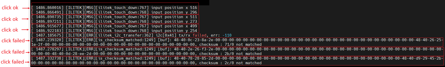

However, when click the screen multiple times, the driver reads the information reported by the touch IC via i2c. Some clicks correctly recognize the coordinate points and respond to touch events, but some clicks check for checksum errors. coordinate information is not recognized correctly.
It appears that the transmission data is prone to errors due to the i2c's unstable transmission signal through transmission. With the same touch IC, communication is generally good when previously connected directly to the i2c of the som. You can read the coordinates and respond with a few checksum errors.

    We click the screen by finger for serveral times, the driver will read messages transfered from touch IC, but only part of our click can be recognized and respond to click events. Checksum error detected for other clicks, can not be resolved into touch positions.
    It seems the i2c communication between 941<->928 <->touch IC  are not stable or incorrect. Because we connect the same touch IC to i2c bus in SoM directly,   touch IC works normally and rarely checksum errors occur.

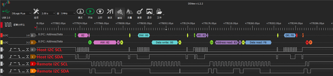

  • dump 941:
    dump 928:
    Since touch data is too much for one click,so we use i2c-tools to get value of  register  0x00 from touch chip to test i2c communication, the command is " i2cget -f -y 1 0x41 0x00 ",
    and at the same time use logic analyzers to catch the process:

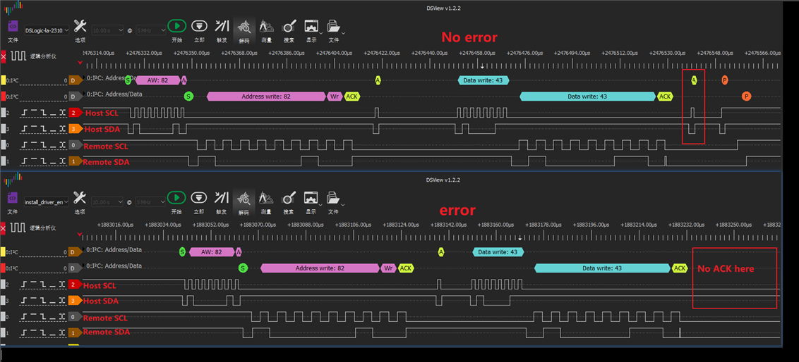

  • We also do some test and make a comparison with a logic analyzer, give some more information to you. We hope this could be helpful.
    In the picture, we test the i2c communication twice(Two operations are the same), one is ok and another has an error。
    You can see clearly that remote slave device(touch chip) send a ACK but there is no ACK in host side, then it leads to communication error in i2c driver and that cause the error -110  in previous replies。

    Thank you for the updated test. This looks like the I2C packets are being dropped due to poor back channel margins. From the 941 reg dump, registers 0xA and 0xB are reporting maxed CRC errors. Would you be able to clear the CRC error registers with the below CRC_ERROR_RESET to see how fast the errors are aggregating?
