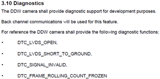

thanks your support always. Do our 935/953 have diagnostic functions as below picture?

Hi Jimmy,
Would you be able to elaborate on the functions here?
The serializer will have the following status registers available to use for system diagnostics: 0x52, 0x55-0x56, 0x5C-0x60. The serializer can also be used for voltage sensing and setting alarms on a specific event. More diagnostics will be available depending on the pairing deserializer.
